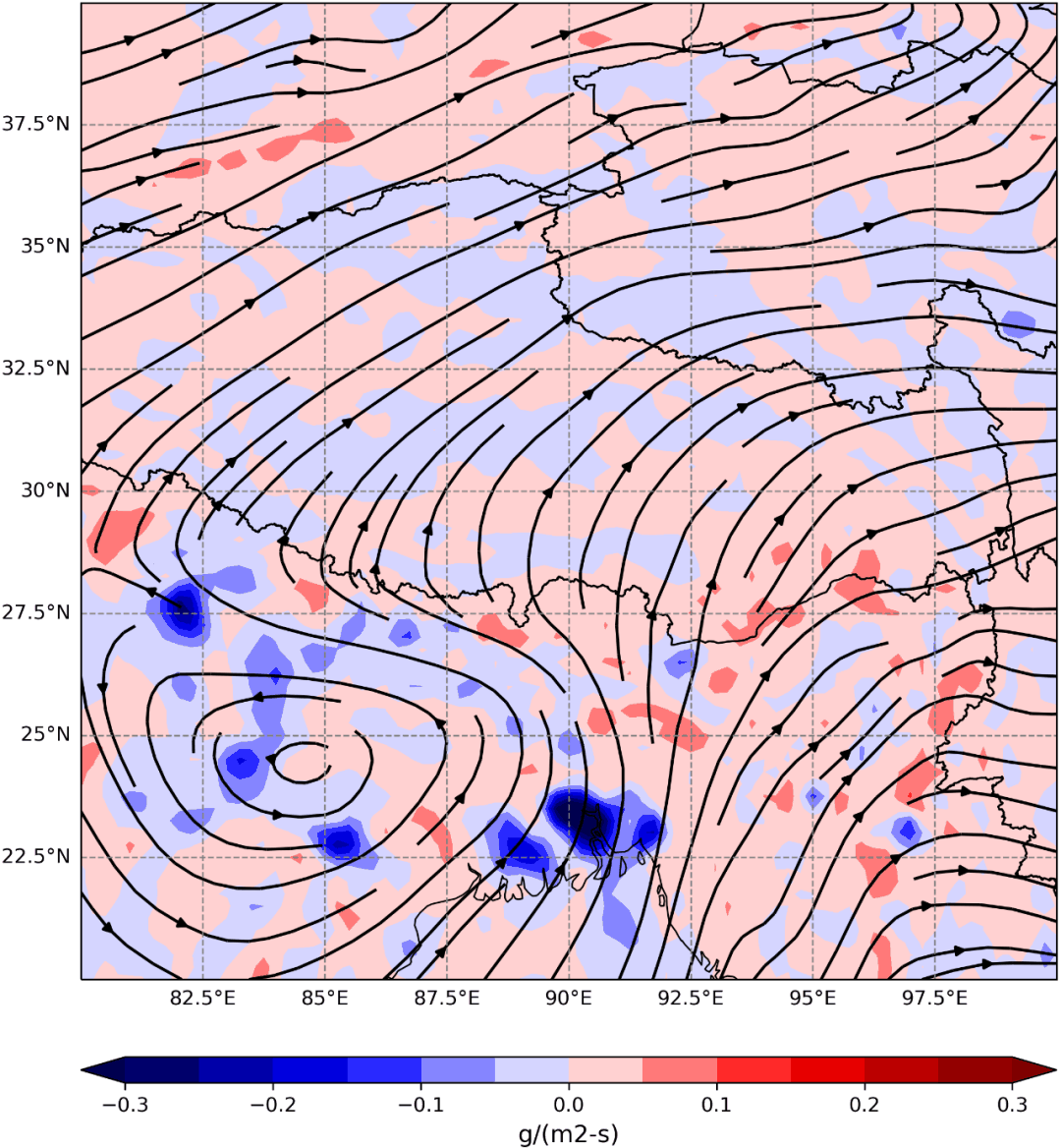

# 画图:
leftlon, rightlon, lowerlat, upperlat = 80, 100, 20, 40
img_extent = [leftlon, rightlon, lowerlat, upperlat]
levs = np.arange(-0.3, 0.3+0.05, 0.05)
fig = plt.figure(figsize=(12,9))
ax = plt.subplot(111, projection=ccrs.PlateCarree())
ax.set_extent(img_extent)
ax.coastlines('50m', linewidth=0.8)
# 整层水汽通量散度填色
mfc_contourf = ax.contourf(lons, lats,
                           iduvq,
                           cmap=cmaps.MPL_seismic,
                           levels=levs,
                           extend='both', transform=ccrs.PlateCarree())
# 整层水汽通量流线
mf_stream = ax.streamplot(lons, lats,
                          iuq.data, ivq.data,
                          color='black', transform=ccrs.PlateCarree())
gl = ax.gridlines(draw_labels=True, dms=False,
                  linestyle='--', color='gray',
                  x_inline=False, y_inline=False)
gl.top_labels = False
gl.right_labels = False
ax.add_feature(provinces, linewidth=1)
position = fig.add_axes([ax.get_position().x0,
                         ax.get_position().y0-0.08,
                         ax.get_position().width,
                         0.02])
cb = fig.colorbar(mfc_contourf, orientation='horizontal', cax=position)
cb.set_label('%s'%iduvq.units, fontsize=12)
# 保存图片
plt.savefig('./plo99.png',dpi=800,bbox_inches='tight',pad_inches=0)
plt.show()
