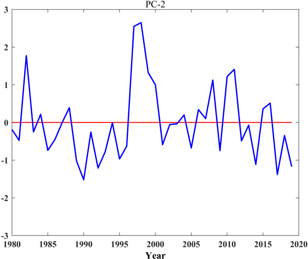

p1=p(r,:);%---修改主成分的时间系数
p2=p(r-1,:);%---修改主成分的时间系数
pp1(1:40)=0;
plot(1980:2019,pp1,'linewidth',1,'color','r');
hold on
plot(1980:2019,p2,'linewidth',1.5,'color','b');
xlabel('Year','FontSize',10,'FontWeight','bold','Color','k');
set(gca,'YLim',[-3 3]);
set(gca,'FontSize',10,'FontName','Times New Roman','FontWeight','Bold')
title('PC-2');

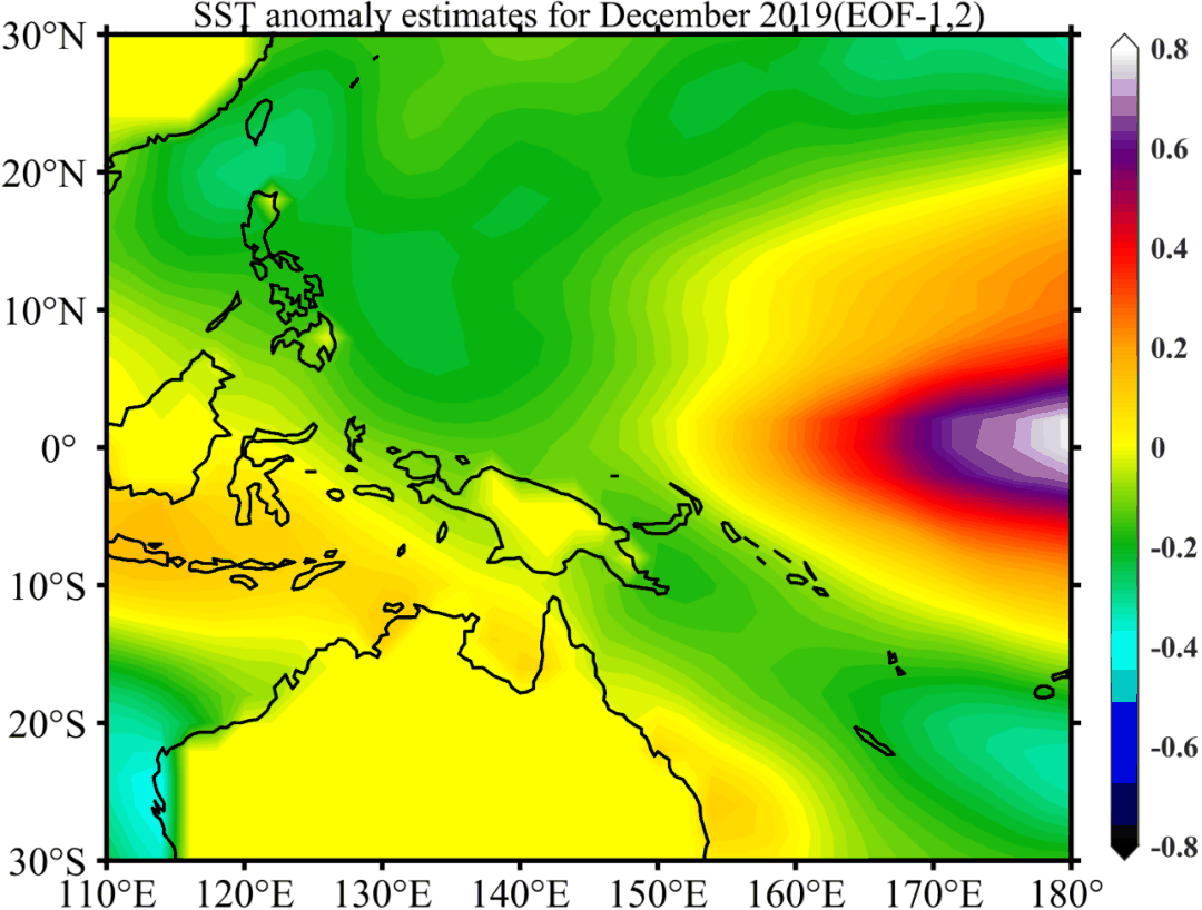

boundary=[110 300 -30 30];
lon_scope = find(lon >= boundary(1) & lon<=boundary(2));
lat_scope = find(lat >= boundary(3) & lat<=boundary(4));
lon_number = length(lon_scope);
lat_number = length(lat_scope);
lat_1=linspace(boundary(3),boundary(4),lat_number);
lon_1=linspace(boundary(1),boundary(2),lon_number);
[plon,plat]=meshgrid(lon_1,lat_1);
guojie=shaperead('bou2_4l.shp');
m_proj('Equidistant','long', [110 180],'lat',[-30,30]);
bou1_4lx=[guojie(:).X];
bou1_4ly=[guojie(:).Y];
m_plot(bou1_4lx,bou1_4ly,'linewidth',2,'color',[0.35 0.35 0.35]);
hold on
eof1_plot=imrotate(x1,90);
eof2_plot=imrotate(x2,90);
% [cs,h]=m_contourf(plon,plat,eof2_plot,'linewidth',0.5);%---估计EOF
[cs,h]=m_contourf(plon,plat,p2(40)*eof2_plot+p1(40)*eof1_plot,'linewidth',0.5);%%----(3)利用EOF的前2模态对2019年12月的海温距平场做出估计(绘图)
D2019=anod(:,:,40);D2019_plot=imrotate(D2019,90);
% [cs,h]=m_contourf(plon,plat,D2019_plot,'linewidth',0.5);%%----(3)实际测量的2019年12月ssta
set(h,'LineColor','none')%取消等值线
set(h,'LevelStep',get(h,'LevelStep')*0.2);
m_coast('color',[0 0 0],'linewidth',1);
hold on
str=sprintf( 'EOF-2');
% str=sprintf( 'SST anomaly for December 2019');
str=sprintf( 'SST anomaly estimates for December 2019(EOF-1,2)');
title(str,'fontsize',10,'color','k')
% m_grid('xtick',6,'ytick',[-30 -15 0 15 30],'fontsize',18);
m_grid('ytick',[-30:10:30],'xtick',[110:10:180],'tickdir','out','linest','none','fontname','Times','fontsize',12,'linewidth',1.5);
% ---设置经纬度,m_grid.m第400和500多行
c=colorbar('eastoutside','ticklength',0);
caxis([-0.8,0.8])
hold on
% 调用ncl色带
load('colorbar-mat/BkBlAqGrYeOrReViWh200_r.mat');
CMap1=flipud(BkBlAqGrYeOrReViWh200_r);
colormap(CMap1);
ax = gca;
axpos = ax.Position;
c.Position(3) = 0.5*c.Position(3);
ax.Position = axpos;
cbarrow;

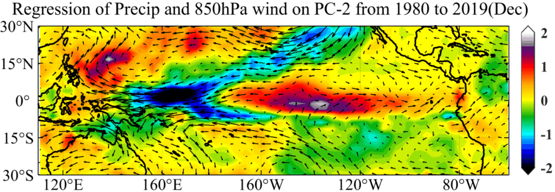

%---用主成分时间序列进行回归分析
clc,clear,close all;fclose all;
data='F:/RMatlab/data20211219/sst.mnmean.nc';
ncdisp(data);
ncinfo(data);
m_proj('Equidistant','long', [110 300],'lat',[-30,30]);
boundary=[0 360 -90 90];
lon=ncread('F:/RMatlab/data20211219/vwnd.mon.mean.nc','lon');
lat=ncread('F:/RMatlab/data20211219/vwnd.mon.mean.nc','lat');
lat1=ncread('F:/RMatlab/data20211219/precip.mon.mean.nc','lat');
lat_scope1 = find(lat1 >= boundary(3) & lat1<=boundary(4));
lat_number1 = length(lat_scope1);
u=ncread('F:/RMatlab/data20211219/uwnd.mon.mean.nc','uwnd');
v=ncread('F:/RMatlab/data20211219/vwnd.mon.mean.nc','vwnd');
pre=ncread('F:/RMatlab/data20211219/precip.mon.mean.nc','precip');
level=ncread('F:/RMatlab/data20211219/uwnd.mon.mean.nc','level');
ud=u(:,:,3,396:12:865);%---1979年1月为第一维度
vd=v(:,:,3,396:12:865);
pred=pre(:,:,24:12:493);
ud=ud(:,:,:);vd=vd(:,:,:);
% pred0=reshape(pred,[144*40,72]);
% b=ones(144*40,1);
% pred0 = cat(2,b,pred0);
% pred=reshape(pred0,[144,73,40]);
% ----一元回归
for i=1:lon_number
    for j=1:lat_number1
        a=pred(i,j,:);a=a(:);
        [b] = regress(a,p2') ;
        reg(i,j)=b;
    end
end
for i=1:lon_number
    for j=1:lat_number
        u=ud(i,j,:);u=u(:);
        v=vd(i,j,:);v=v(:);
        [b1] = regress(u,p2') ;
        [b2] = regress(v,p2') ;
        reg1(i,j)=30*b1;
        reg2(i,j)=30*b2;
    end
end
lat1_1=linspace(boundary(3),boundary(4),lat_number1);
[plon1,plat1]=meshgrid(lon_1,lat1_1);
m_proj('Equidistant','long', [110 180],'lat',[-20,30]);
%-------更改这里(印度洋和太平洋)
reg_plot=imrotate(reg,90);
reg1_plot=imrotate(reg1,90);
reg2_plot=imrotate(reg2,90);
figure('color',[1,1,1])
[cs,h]=m_contourf(plon1,plat1,reg_plot,'linewidth',0.5);
hold on
m_quiver(plon(1:2:end),plat(1:2:end),reg1_plot(1:2:end),reg2_plot(1:2:end),2,'color','k')%%风场矢量图,'2'表示扩大多少为多少倍
hold on
str=sprintf( 'Regression of Precip and 850hPa wind on PC-2 from 1980 to 2019(Dec)\n');
% m_grid('xtick',6,'ytick',[-30 -15 0 15 30],'fontsize',10);
m_grid('ytick',[-20:10:30],'xtick',[110:10:180],'tickdir','out','linest','none','fontname','Times','fontsize',12,'linewidth',1.5);
%---设置经纬度,m_grid.m第400和500多行
caxis([-2,2])
hold on
% 调用ncl色带
colormap(CMap1);
ax = gca;
cbarrow;
[h1,h2,h3]=legend_vc('northeast',plon,plat,reg1_plot,reg2_plot,2,2);
