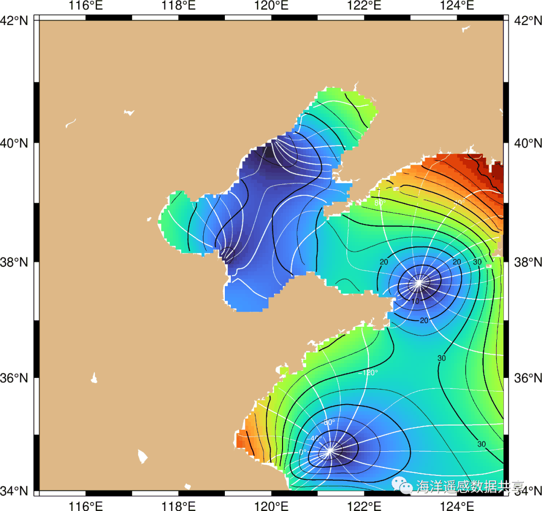

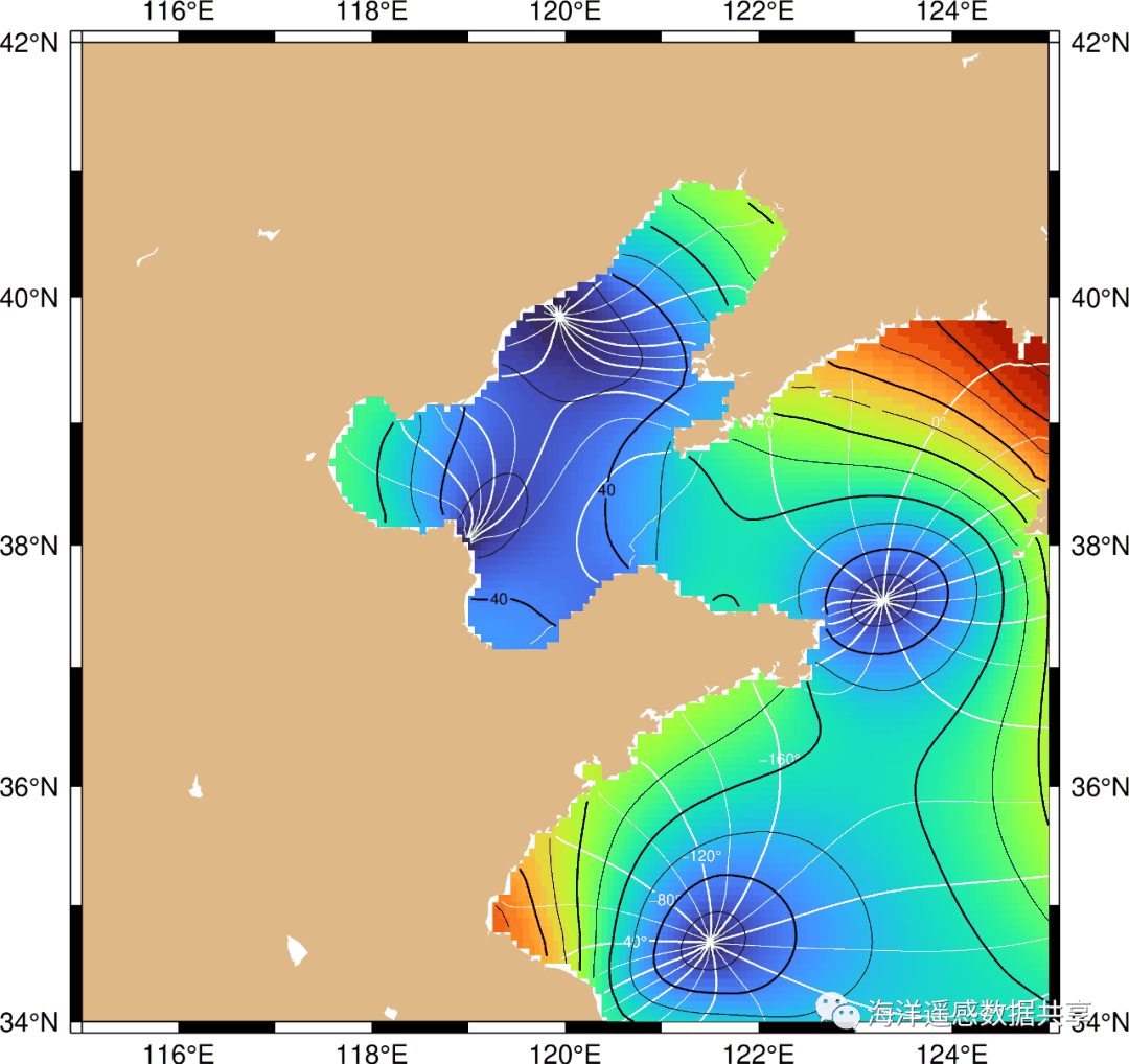

以山东周边海域M2和S2分潮为例绘图。
主要用到了grdcontour绘制等值线,在相位一行代码中,注意加入-Z+p,代码如下。
[C] 纯文本查看 复制代码
#!/usr/bin/env bash
ps=sd.ps
gmt pscoast -R115/125/34/42 -JM6i -Baf -Gburlywood  -Di -A10 -P -K --FORMAT_GEO_MAP=dddF > $ps
gmt grdimage "m2.nc?amplitude" -J -R -O -K -Q >> $ps
gmt pscoast -R -J -Gwhite  -Df -K -O >> $ps
gmt grdcontour -R "m2.nc?phase" -J -Gl123/37/120/34,122/39/125/39 -C20 -A40+f7p+a0+u@. -Z+p  -Wc0.25p,white -Wa0.75p,white -O -K  >> $ps
gmt grdcontour -R "m2.nc?amplitude" -J -GlBL/TR -C20 -A40+f7p+a0  -Wc0.25p,black -Wa0.75p,black -O -K  >> $ps
M2

S2

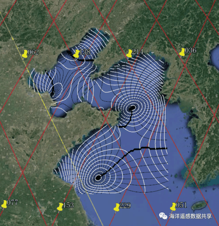

首先使用grdcontour的-D输出等值线文件,再使用gmt2kml制作kml文件,可进一步导入Google Earth。
+ T( w1 u7 _' q
[C] 纯文本查看 复制代码
# Output data
gmt grdcontour -R "m2.nc?phase" -J -C10 -A20+f7p+a0  -Wc0.25p,gray -Wa0.75p,gray -Dcontours_p.txt
gmt grdcontour -R "m2.nc?amplitude" -J -C10 -A20+f7p+a0  -Wc0.25p,red -Wa0.75p,red -Dcontours_a.txt
# Transform to kml
gmt 2kml contours_p.txt -Wthick,black -Fl > contours_p.kml
gmt 2kml contours_a.txt -Wthick,white -Fl > contours_a.kml
导入Google Earth
